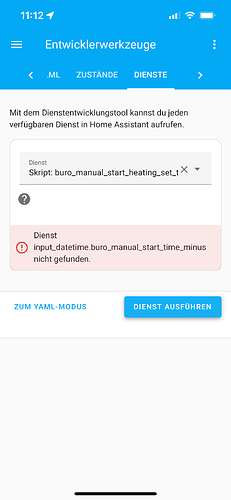

i want to integrate a Button with mushroom that calls a service.
the script is in my scripts.yaml file but when i press the button i get an error message which is:
Dienst input_datetime.buro_manual_start_time_plus hat den Dienst script.buro_manual_start_heating_set_time_script_plus aufgerufen, der nicht gefunden wurde.
i allready searched several hours but did not find my mistake that causes the error.
Does anyone of you see the problem in my code?
I am relatively new to HA and yaml code and i realy appreciate any help.
Thanks in advance
Michael
