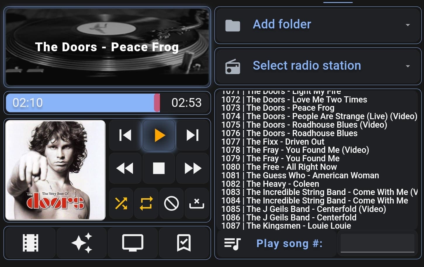

How were you originally planning to have your guests use the Input Number helper? Were they supposed to enter a number?
So now they enter the number in an Input Text helper?
Yes, screenshot below, bottom right.
With input_number the best I could do is leave a “0” as default;
now I just add float(0) to previous templates and send a " " to clear the field.
Wall tablet Winamp/Wacup frontend with limited control for guests.
That would have been my first choice as well. The 0 serves as a visual cue, for the user, of what’s expected in that field. Given a list of numbered choices, 0 is an intuitive ‘non choice’. In addition, an Input Number automatically constrains the user’s input to a numeric value.
Now that you have switched to an Input Text, be sure to use its pattern option to restrict input to integers and an empty string (otherwise, by default, Input Text allows for any characters).
