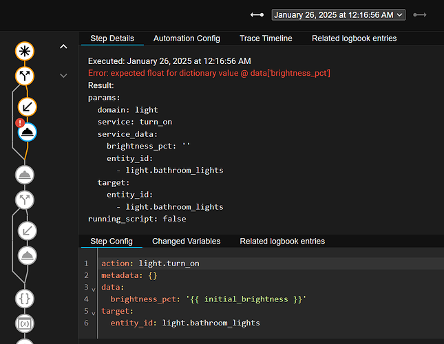

Hi guys. I have a little problem and need some help.
I want to set the brightness of a light entity with a variable. However it always throws an error and I can’t understand it.
Here is the error message:
This is how I set the variable under actions:
variables:
initial_brightness: >-
{{ (100 / 255 * state_attr('light.bathroom_lights', 'brightness')) |
round(0) }}

Edwin_D
(Edwin D.)
January 25, 2025, 7:18pm
4
Variables should not lt be part of the action array (note the - before it) but a level higher I think.
Also, if the light is off, the template will throw an error. It is likely that is what you are testing for (I can’t tell because of those wretched device conditions), but the template is evaluated when the light is off too. So I’d also add a | float(0) to it to prevent the error.
The automation trace should show the variable values, though you might need to download the trace json to see it.

I’ve looked at the documentation here and they say that the variables in the variables action can be templated.
I’ve also added the “float(0)” as you said but the error still persists.
First run when lights are off. Variable gets set properly:
Second run, when lights are on but with a different brightness level. The variable should set the brightness to the previous state:
Obviously you cannot use the variable before it exists.
Variables are not retained between automation runs.
lexlex
January 26, 2025, 1:25am
7
thank you for the tip! I thought they will be retained. I’ve created a Number Helper now and it works flawless.
