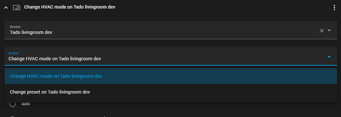

I want to set the temperature of my Tado thermostat through an automation. When I navigate to the device I can set the temperature manually, which is great because it proves HA is able to set the temperature.
However, when I try to set it through an automation I only see 2 options, neither can set the temperature.
How do I ‘open up’ this device so I can talk to it through an automation?

Use the service called “climate: set target temperature”
