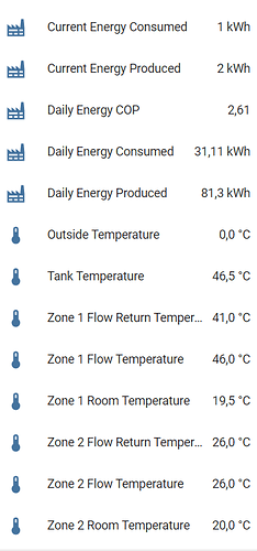

@vilppuvuorinen thank you a lot for your work. I was able to deploy the melcloud on my HA and easily fix some sensors that was not correctly reporting.
I’m able to get the following states :
I have a combo of: PUHZ-SHW80VHA + EHSC-VM6C
In my case the room zones flow was not mapped correctly.
I used the following fixes in sensor.py :
#Flow
value_fn=lambda zone: zone._device._device_conf['Device'][f"FlowTemperatureZone{zone.zone_index}"],
value_fn=lambda zone: zone._device._device_conf['Device'][f"ReturnTemperatureZone{zone.zone_index}"],
#Energy
value_fn=lambda x: x.device._device_conf['Device']['DailyHeatingEnergyProduced'],
value_fn=lambda x: x.device._device_conf['Device']['DailyHeatingEnergyConsumed'],

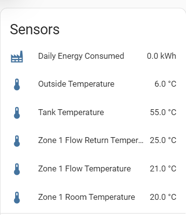

Two weeks ago our newly built house with a ATW heatpump was finished (PUHZ-SW100YAA, ERST30C-VM2ED combo).
I see you have daily energy sensors for consumed, produced and COP working. I have a one zone setup but am missing those very important sensors:
Could you assist me getting these sensors exposed?
