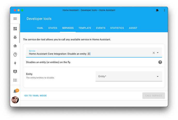

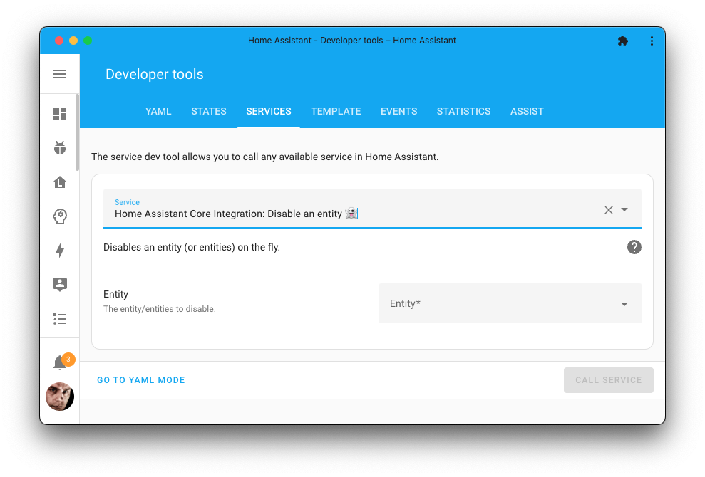

Actually, I just found that spook offers the hide/unhide entity service call, so I’ll probably go that way. A pity there are no native services tho.
