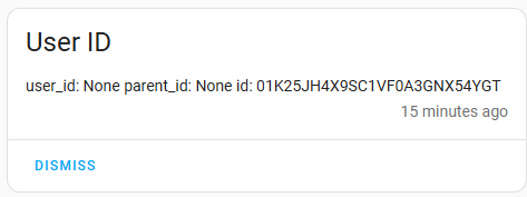

With that being said, I’m having issues with my automation setting this helper, so I created an automation just to indicate if the entity is turned on and who did it…yet the user_id variable is none even when turned on by Amazon echo. I thought it would only get set to none when triggered by an animation. Any ideas of where I’m going wrong?

which then gives this notification:
The context shown in you example is what would be expect if someone manually flipped the switch.
Action id parent_id user_id
Physical Not None None None
Automation Not None Not None None
UI Not None None Not None
That table is a bit oversimplified, and context.parent_id is not reliably set for automations, depending on what kind of trigger they use.
More details here: How to use context
This will help quite a bit. In my case, I will have to check only the parent_id to ensure it is set to anything other than none as I only want to identify if it was an automation that turned on the attic fan. Thank you!
