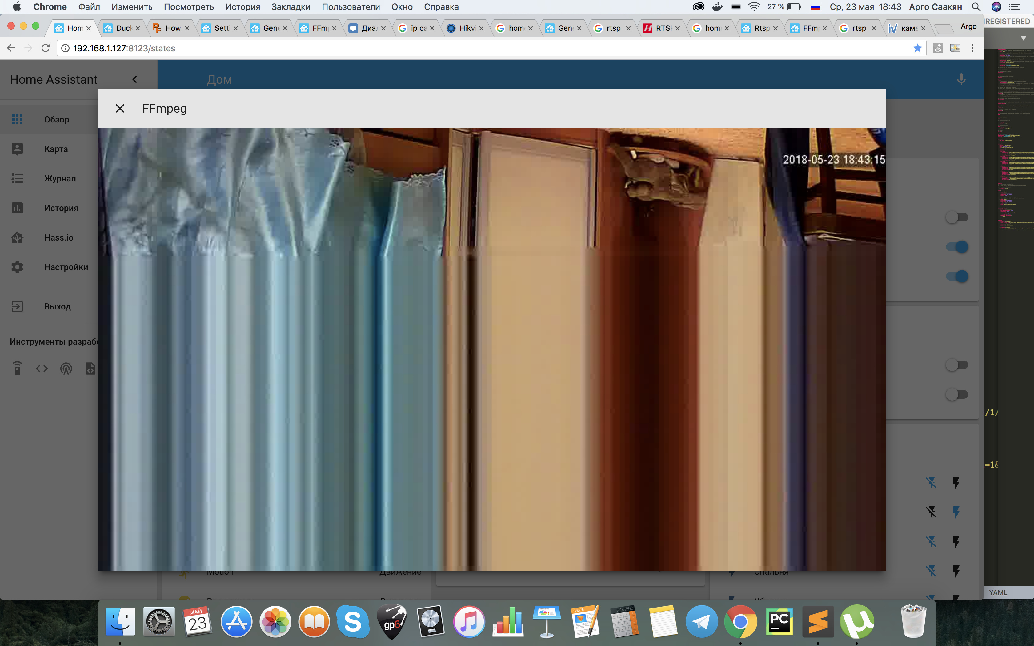

Here is what I got with rtsp
It is trying to be real time video, but again it shows few images than stops for 2-5 seconds, then again. Tried with 2 cameras (optimus and hiwatch), first one is connected trough LAN, second one trough wi-fi. What can help to get good video?
g0g0
May 23, 2018, 3:56pm
8
On what host you run HA?
With RPi3 I can get fluent video only in very low resolution like 640x360, on high resolution I get same result one image per 10 seconds and bad picture like in your screenshot

It’s the point of camera providing low quality stream so RPi3 can handle it,
you can change resolution in HA:
camera:
- platform: ffmpeg
input: -i rtsp://0.0.0.0/blabla -vf scale=640:360
but like this image processing will done on RPi3 and still will be slow,
if your camera has web interface like HIK cameras, you can change there
