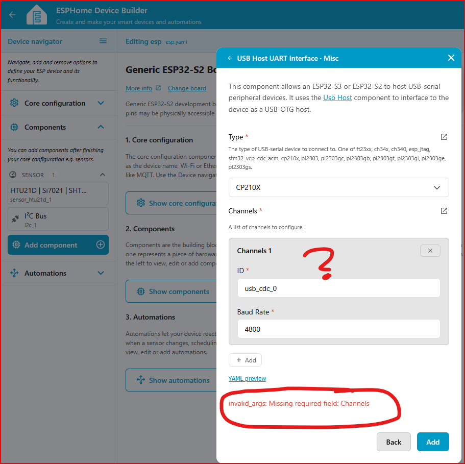

Setting up component USB Host UART Interface for device ESP32-S2-DevKitC-1 does not work
Hi all,
I'm a complete beginner when it comes to ESPHome, but I hope you can help me!
I use the ESP32-S2-DevKitC-1 device and in general everything works fine.
But when want to set up the component USB Host UART Interface for this device I get the following error message No matter what I enter in the ID field as you can see in the screenshot.
Do you know which number or text I need to enter in this field for my device?
Thank you very much and kind regards
Thomas
Here is the Validate output, but I do not know if this helps...

I'm not familiar with usb host, but your yaml doesn't include that component.
@Karosm
Thank you for answering!
Yes, my yaml does not include this component because I cannot create a valid configuration because of the error show in the screenshot (invalid_args: Missing required filed: Channels).
Does anyone know how I can sort this out?
Thank you!!!
Ahh, sorry for that. Neither I'm familiar with device builder.
So if you give id like hostch_1, it doesn't let you add it?
Looks like an issue with device builder - you will need to configure it directly in yaml rather than using the wizard.
Thank you!
Doing it directly in yaml was possible.
With the current version of the device builder it works.
