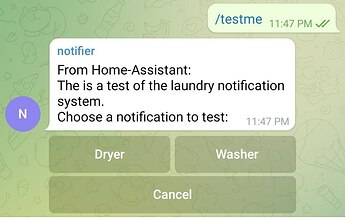

In my previous example, if you send the “testme” command, it will then use the automation below to send a message back with 3 buttons:
- id: 'telegramtesttrigger'
  alias: 'Telegram bot test sequence'
  trigger:
    - platform: event
      event_type: test_telegram_bot_notify
  condition: []
  action:
  - service: notify.tg_notification_chat
    data_template:
      title: "From Home-Assistant:"
      message: "The is a test of the laundry notification system.\nChoose a notification to test:"
          inline_keyboard:
          - 'Dryer:/testdryer, Washer:/testwasher'
          - 'Cancel:/removekeyboard'
That looks like this, inside telegram:
