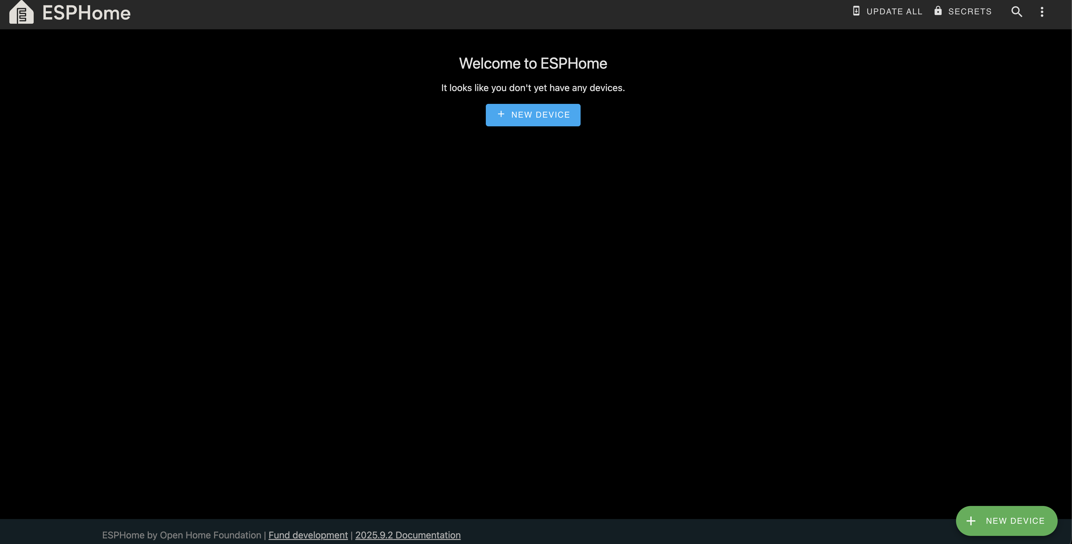

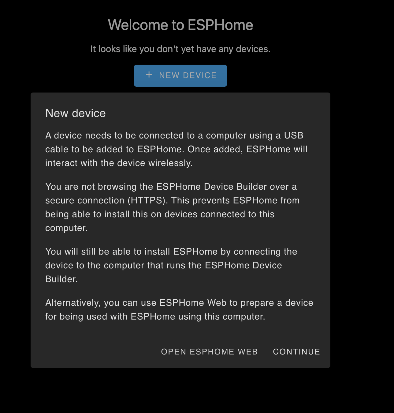

In this case, I used the ESPHome Device Builder (port 6052) (I think in theory you can use docker run to execute CLI against the container - but I didn’t want to risk breaking anything there). From the web UI clicked on “New Device”, then Continue, then “Import from File”, then selected the YAML file I had from above.
At first, I think it tried to find the device via a local DNS alias - either way, I had to specify the IP address. There were a bunch of posts online that mentioned using manual_ip - for Ethernet this would be:

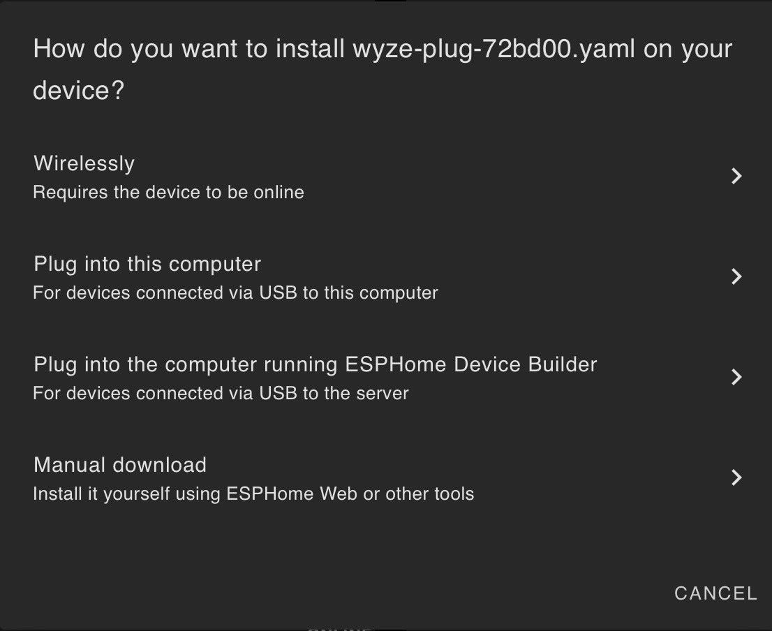

I assume if I’m flashing a new device (i.e. doesn’t have ESPHome), then I will need to get ESPHome (e.g. via Docker) working locally on my Macbook, so that I can push directly via the debug pins, right?

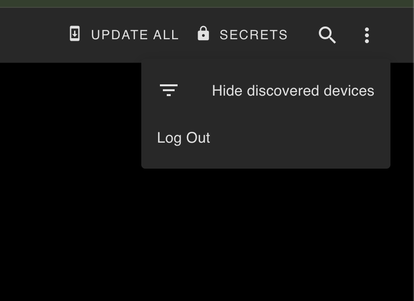

And it seems like the ESPHome Device Builder not picking up the devices - is that working as intended, or not? Or should it be using mDNS and picking those up somehow?
I didn’t see the mdns component listed on the stock GL-S10 configuration, but is it meant to be in there automatically, or should it work out of the box?
