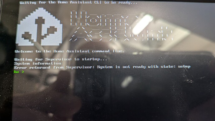

I"m trying to move from a pi to HomeAssistant Green. Something went wrong when I first tried to a created an SD and rebooted and it seems to boot just fine but, at the end, it just shuts itself off. Until that point the screen seems normal and like my pi.
I used a camera to capture the boot screen. It powers down shortly after it finished loading the OS

I forget to include the screen shot (using a camera) of what I see after a night of restoring.

HA looks operating normal, but have same output when plug HDMI cable
