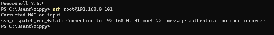

I’ve tried setting up SSH in HA several times now, but I keep getting the same error message:
‘Corrupted MAC on input.
ssh_dispatch_run_fatal: Connection to 192.168.123.170 port 22: message authentication code incorrect’.
I hope someone can tell me what I’m doing wrong.
Thanks in advance.
It refers to hmac probably. Setup your connection with different sha (512 or so), or see if server side can accept different hmacs.

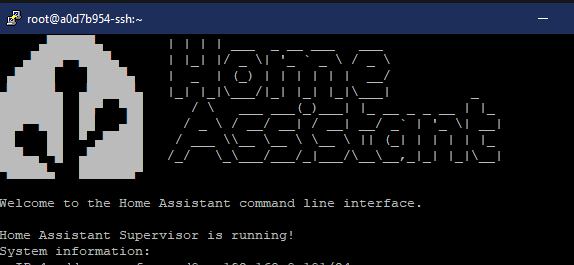

Thanks for your reply, it works. But then I can’t access the configuration.yaml.
I had weird trouble connecting putty to Home Assistant once. The advice from the devs was to try the windows terminal, and that did indeed work. I’ve used Solar-Putty to manage my SSH sessions since then. The free version does display a small ad on the main session index page but not the terminal windows.
