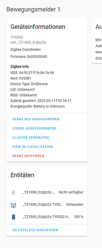

My problem is that the motion detector entity of the device is almost always unavailable. The device entity itself goes offline after a while if there is no motion but reconnects when motion is detected. Did I miss something in the configuration?

I have the same problem with this. Likewise with the smart button from Lidl. That button turns itself off. I got around that by adding it to the automation so that it would be activated again. I don’t like that, because then double click or longpress doesn’t work. But at least something. It is different with the PIR sensor, it cannot be done the same way. I read in another thread that it works over ZigBee2MQTT. But I don’t want to install another server/gateway into the system because of that one device. This requires either docker or another RPi.
