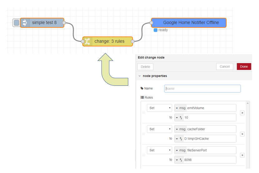

Try out the google notification from node-red. You can choose your announcement volume and it restores after announcement the original volume.
You can setup cache mode, thus each announcement is cached and no internet connection is needed for the same announcement.
Hi @OM_luxbg , i like your suggestion. I would like to use an announcement when the doorbell is pressed. This needs to be at a higher volume then the regular volume. I can’t seem to find this option in my node red. I am running home assistant in supervisor mode. Do i need to add this specific function to node red? And if so, how can i do that? BTW i’m running in a docker in Raspbian.
you have to setup a variable “emitVolume” on the msg.
here you can find the detailed setup instructions. github link
You can also import to nodered this code section as a sample
[{"id":"2a4252c0.5c4fce","type":"subflow","name":"GoogleHomeNotification","info":"","in":[{"x":50,"y":30,"wires":[{"id":"2e760d93.791962"}]}],"out":[]},{"id":"5ae262d6.e988ac","type":"switch","z":"2a4252c0.5c4fce","name":"GoogleNotifyDestination","property":"destination","propertyType":"msg","rules":[{"t":"eq","v":"living","vt":"str"},{"t":"eq","v":"bureau","vt":"str"},{"t":"eq","v":"all","vt":"str"}],"checkall":"true","repair":false,"outputs":3,"x":450,"y":260,"wires":[["d4c7c0cb.b476e"],["33e2797c.5b5606"],["d4c7c0cb.b476e","33e2797c.5b5606"]],"outputLabels":["Google Home","Google Home mini",""]},{"id":"d4c7c0cb.b476e","type":"googlehome-notifier-offline","z":"2a4252c0.5c4fce","server":"da212a5d.597b08","name":"Google Home","x":800,"y":180,"wires":[]},{"id":"33e2797c.5b5606","type":"googlehome-notifier-offline","z":"2a4252c0.5c4fce","server":"ebe165de.892128","name":"Google Home Mini","x":790,"y":320,"wires":[]},{"id":"2e760d93.791962","type":"change","z":"2a4252c0.5c4fce","name":"","rules":[{"t":"set","p":"cacheFolder","pt":"msg","to":"d:\\tmp\\GHCache","tot":"str"}],"action":"","property":"","from":"","to":"","reg":false,"x":200,"y":260,"wires":[["5ae262d6.e988ac"]]},{"id":"da212a5d.597b08","type":"googlehome-config-node-offline","z":"2a4252c0.5c4fce","ipaddress":"192.168.20.194","name":"Google Home","language":"fr"},{"id":"ebe165de.892128","type":"googlehome-config-node-offline","z":"2a4252c0.5c4fce","ipaddress":"192.168.20.197","name":"Google Home Mini","language":"fr"},{"id":"3f60aa46.aa4026","type":"subflow:2a4252c0.5c4fce","z":"c348d271.07631","name":"","env":[],"x":910,"y":360,"wires":[]},{"id":"8c73b93b.3db918","type":"change","z":"c348d271.07631","name":"","rules":[{"t":"set","p":"destination","pt":"msg","to":"all","tot":"str"},{"t":"set","p":"emitVolume","pt":"msg","to":"50","tot":"str"}],"action":"","property":"","from":"","to":"","reg":false,"x":560,"y":360,"wires":[["3f60aa46.aa4026"]]},{"id":"fb06ce90.3001b","type":"inject","z":"c348d271.07631","name":"","topic":"","payload":"ceci est un test","payloadType":"str","repeat":"","crontab":"","once":false,"onceDelay":0.1,"x":260,"y":360,"wires":[["8c73b93b.3db918"]]},{"id":"4a281a.8a2917e8","type":"inject","z":"c348d271.07631","name":"","topic":"","payload":"ceci est un test","payloadType":"str","repeat":"","crontab":"","once":false,"onceDelay":0.1,"x":260,"y":540,"wires":[["ccef16e8.5ee2d8"]]},{"id":"ccef16e8.5ee2d8","type":"change","z":"c348d271.07631","name":"","rules":[{"t":"set","p":"emitVolume","pt":"msg","to":"50","tot":"str"},{"t":"set","p":"cacheFolder","pt":"msg","to":"D:\\tmp\\GHCache","tot":"str"},{"t":"set","p":"fileServerPort","pt":"msg","to":"8098","tot":"str"}],"action":"","property":"","from":"","to":"","reg":false,"x":560,"y":540,"wires":[["429d4f1d.2d91c"]]},{"id":"429d4f1d.2d91c","type":"googlehome-notifier-offline","z":"c348d271.07631","server":"b8b08a71.387228","name":"","x":900,"y":540,"wires":[]},{"id":"9f10712d.fc031","type":"comment","z":"c348d271.07631","name":"direct notification flow to a single google device","info":"","x":340,"y":500,"wires":[]},{"id":"1a676c3c.0a0bc4","type":"comment","z":"c348d271.07631","name":"indirect notification flow using a node red subflow \"Google Home Notification\" addressing multiple google devices at the same time","info":"","x":590,"y":320,"wires":[]},{"id":"b8b08a71.387228","type":"googlehome-config-node-offline","z":"","ipaddress":"192.168.20.194","name":"","language":"fr"}]
