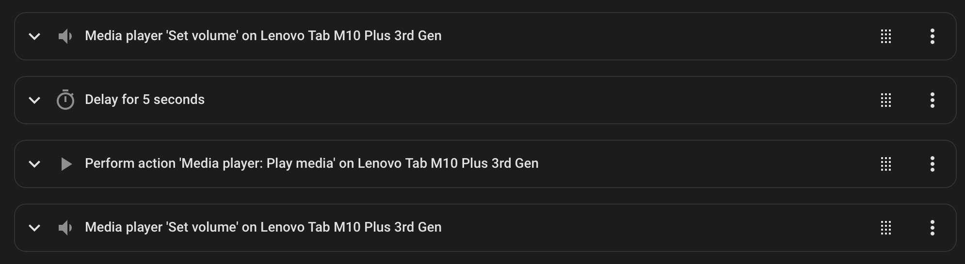

Hi There, Im trying to set the volume of our Lenovo wall tablet to a low volume before playing a sound and then turning it back up again. If i do these actions manually from the automation, then the it plays at the correct volume, but when the automation runs it does not. Any ideas?

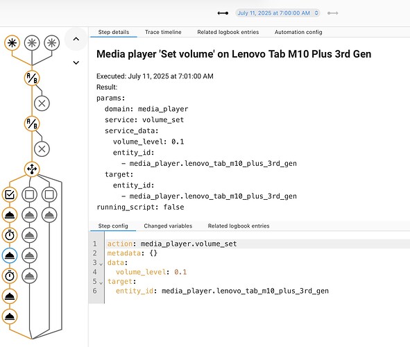

But at first glance there seems to be nothing wrong, check the traces to see what is happening.
Thanks for the reply… Here is the entire automation. Basically locking and unlocking our cat door at specific times of the day. The cats didn’t understand when it was unlocked in the morning as does it silently, so we added a cat noise - after a while, now they understand that specific noise is their door unlocked :slight_smile:
Note: We have an input select helper for the cat door setting, there is another automation that actually triggers the cat door setting based on the choice of the input select - so we can have a manual choice on our kitchen dashboard.

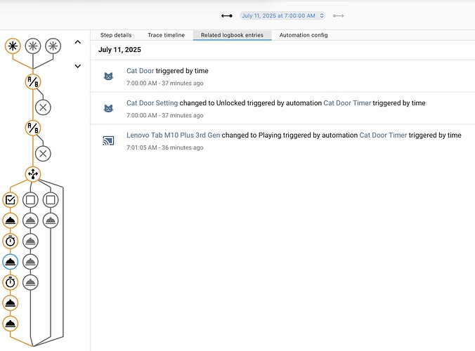

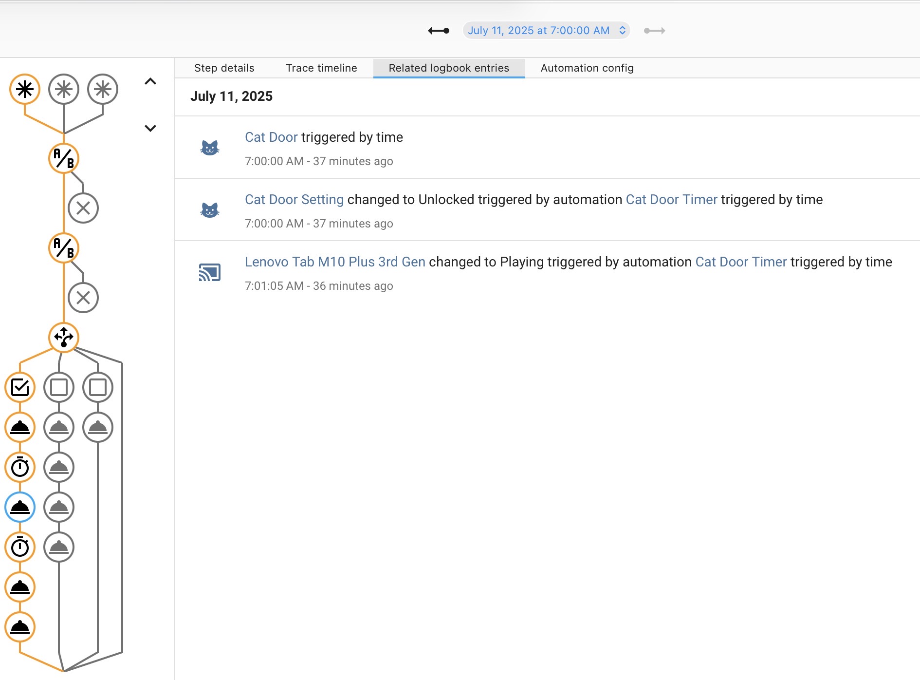

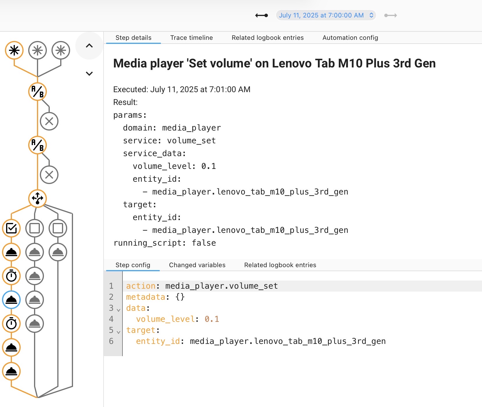

Looking at the race time line, it does not look like those things are actually happening… am i missing something here?

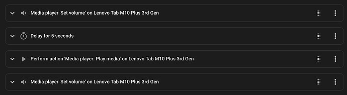

Update here - I figured out what was going on, I needed a delay in between playing the media and turning the volume back up. It was triggering media_player.play_media and then media_player.volume_set - but the delay in the tablet playing the media was obviously more than media_player.volume_set
