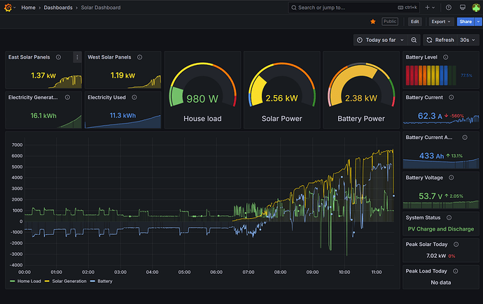

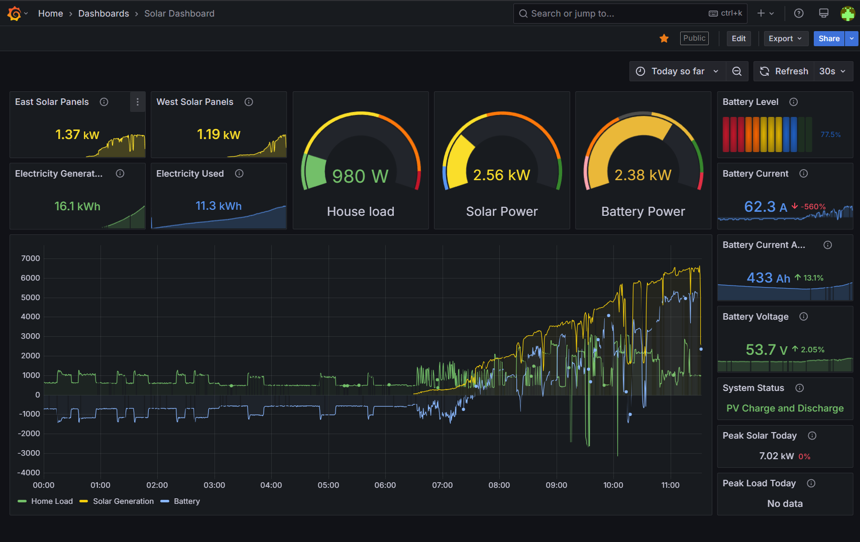

I worked on a mini web app for it, using the RESTful API.
As an update to this, I decided to improve and work on a better real-time web app for this.
What I did was to send the data to InfluxDB, then connect InfluxDB to Grafana and then make a remote public dashboard based on it using Cloudflared.
I worked on it using the Add-ons present in Home Assistant, so there’s no need for additional hardware or where to host things separately.
Here is a link to the dashboard here.
I also wrote a detailed guide on how to achieve it here.
