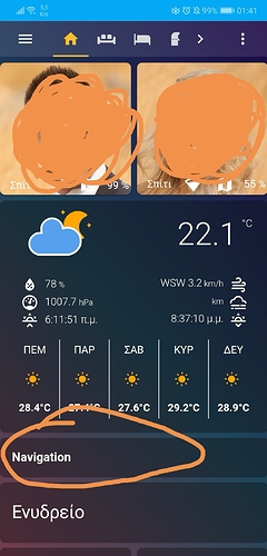

Hi again Gareth,
I’m trying to make the vertical lines but can’t figure it. Could you please help?
I tried this:
content: |
  ## Καλώς ήρθες, {{user}}
style: |
  ha-card {
    margin: 0px 14px -5px 14px;
    box-shadow: none;
    background: none;
  ha-icon {
    float: right;
  h2 {
    font-size: 26px;
    font-weight: 100;
    padding-left: 10px;
    border-left: 3px solid var(--colour-yellow);
type: markdown
But got this:
Do you just create a manual yaml?

This code goes to Lovelace?
yes it does
Nah, same result again. What am I missing?
Is it the standard markdown card?
Edit: Found it. Need card-mod plug-in.
