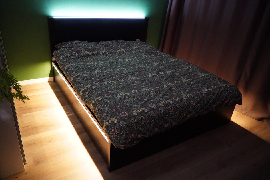

Hi all! Thought I’d share with you fine folks one of my own home projects that I documented, so it helps you now and me in the future. I hacked in some lights and sensors into my IKEA bed, here’s the result.
I wrote up the full build on my blog here: Setting the mood with a DIY IKEA smart bed hack · Eelviny
Any feedback is appreciated, anyone else made a similar project for comparison?

Perhaps some carefully positioned motion sensors directed at foot traffic might be a more reliable way to trigger night lights?
Or supplement the weight sensors?
I have some usb rechargeable dumb ones which are oriented on making sure you don’t stub your toe on the bed corners. I like red night lights for nightime bathroom visits as that colour is most gentle on waking eyes (I just open them up and cover the leds with red electrical tape:). It’s one of those things I haven’t bothered making smart as the dumb version works so well.
Totally agreed on the red lights! All my ceiling lights in the house have mmwave presence sensors along with RGB, so they glow a soft red when you’re walking down the corridor. That’s a blog post for another time though.
Someone over on Reddit also mentioned that they use IR sensors (not motion sensors, not sure whether they just mixed up the terminology though) pointed at where your feet would land to know if you got out of bed. Something to try for a V2.
