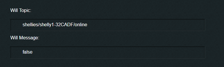

here is a configuration that includes the LWT for a shelly1:

then in the box for the LWT in the shelly itself:

Thank you, I had the “relay” verbiage in the online topic statement. Thanks for your config. it is working now.
