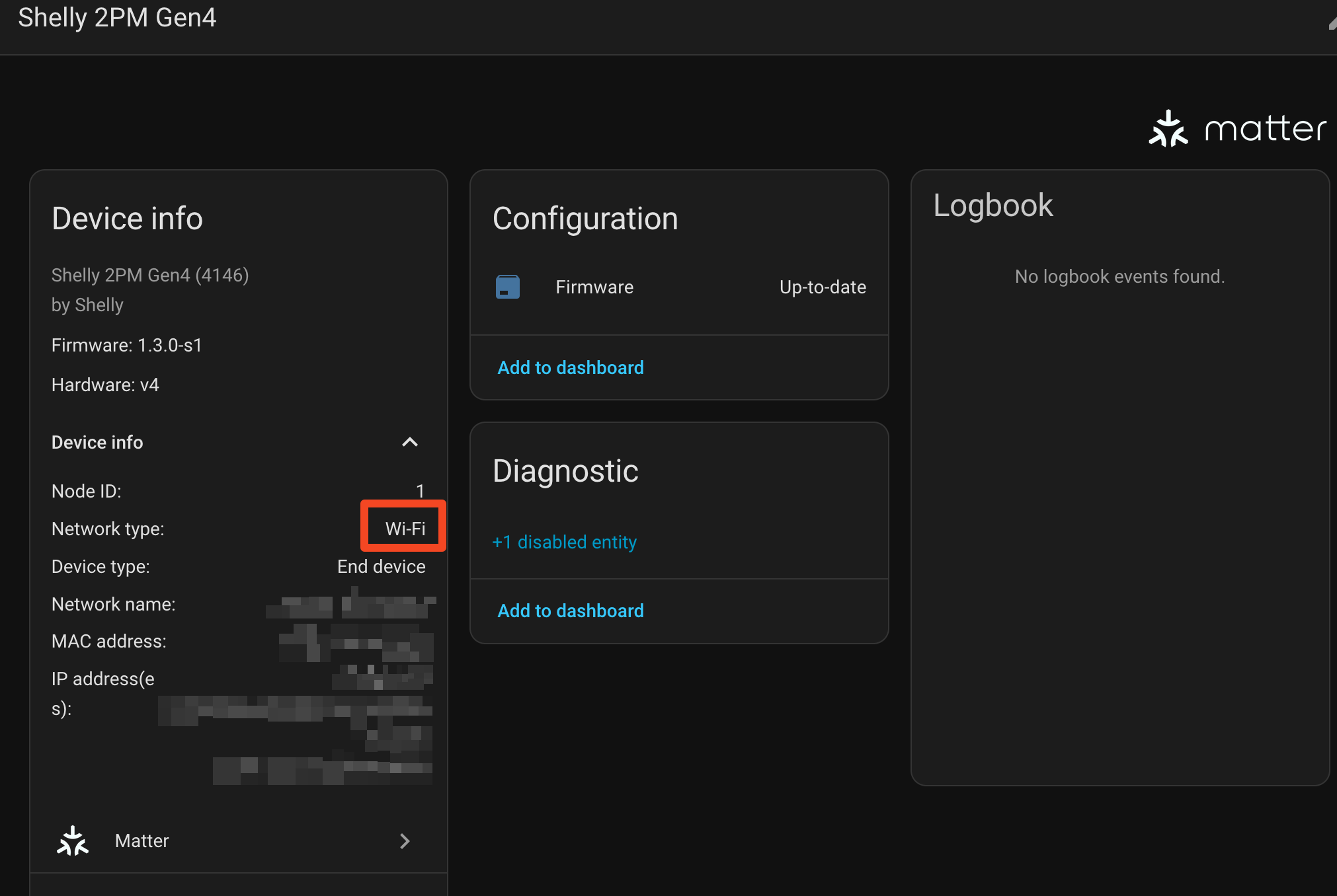

Now in Home Assistant, under the Matter Integration, I see both shelly devices listed, but it clearly states they are connected over my home wifi network.

Where do you see Thread ?
Network name shows the SSID of my home network.

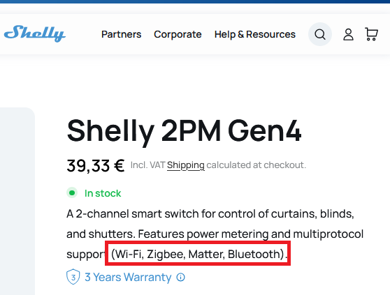

The Shelly 2PM Gen4 is a Matter over Wifi device, there is no mention of Thread on the Shelly product page.
ouch, my mistake.
There was a possible conversion from zigbee to matter firmware in the GUI of the Shelly and I made the following hasty deduction: "well if it can Zigbee, which is based on IEEE 802.15.4, and there’s a firmware conversion to do Matter required, clearly it is going to be Thread, since it’s also based on IEEE 802.15.4”
