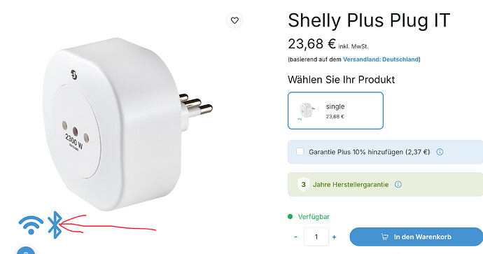

I would like to know if to use the Shelly BLU family a gateway is required to be integrated into Home Assistant, or if it is possible to use the Shelly Plus Plug IT because I don’t find information of IT version but is “Plus”, that Plug have the possibility of being used as a Bluetooth gateway?
Can I connecting the Shelly BLU devices directly to the server’s Bluetooth as happens with the Xiaomi BLE without gateway?
Thanks.
The addition “IT” only says =“Italian standard”
so it is a Plus Plug S
See: https://www.shelly.com/de/products/shop/shelly-plus-plug-it?srsltid=AfmBOooljwDZMwcLJlxn0mGgU_COpi8I_XQ8BjatxYxS0F6Lath0AKcA
Thank you very much, I will use it as a gateway.
