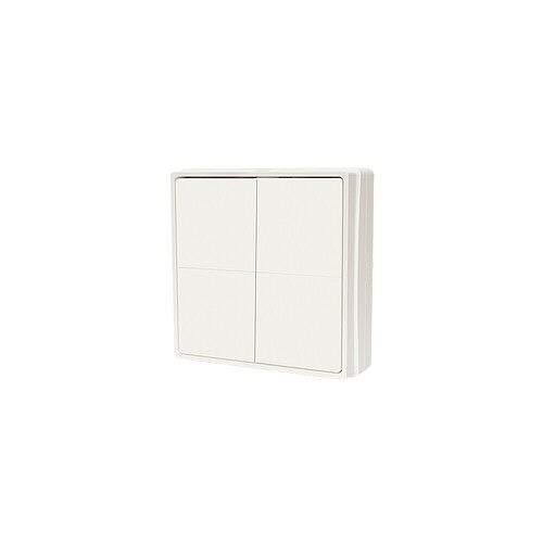

Shelly BLU RC 4-button bluetooth remote with conditional disabling
This is an updated version of the excellent blueprint provided by @duittenb, which itself is inspired by blake.dubiel’s blueprint as enhanced by Shiroe93. Unfortunately, new user restrictions are stopping me from adding more pretty pictures and hyperlinks.
This version adds the optional ability to conditionally enable or disable the remote based on a Toggle (boolean) helper that you create. For example, you may want to temporarily disable your remote when your toddlers decide to pick it up and start mashing buttons.

This also seems to work nicely with Shelly Blu Wall Switch 4
