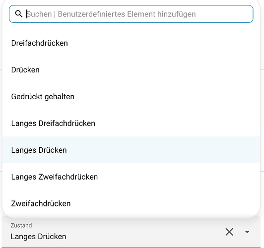

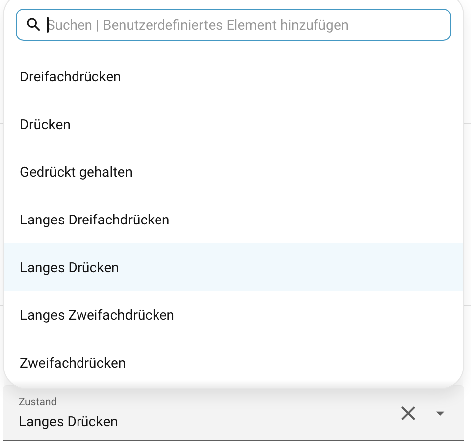

I want to use the features of the Shelly BLU Remote Control ZB for long or double press.
The feature is here in HA, but HA doesn´t recognize the event when triggered.
Single click works perfect.
Does anybody have an idea?

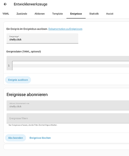

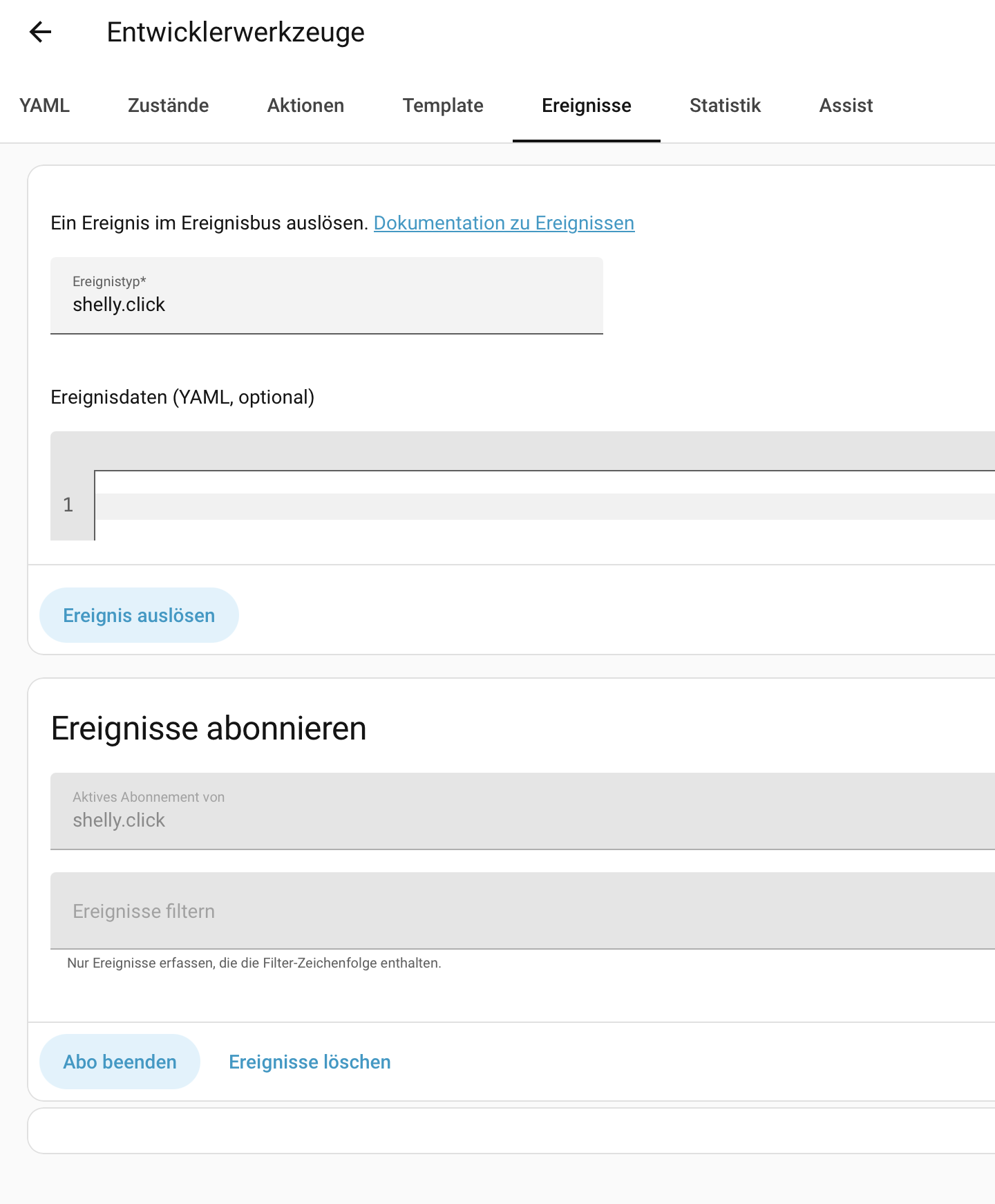

you can use Developer Tools/Events to check what is really received when clicked, double-clicked, etc.
I don´t see anything. What am I doing wrong?
Sorry, I´m new to HA.

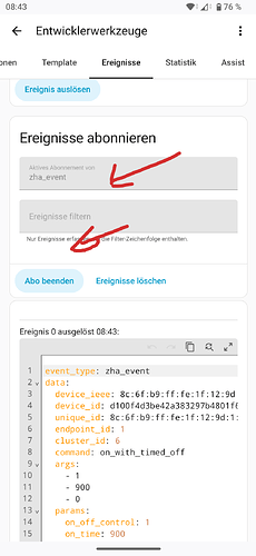

If you are using ZHA for Zigbee you should subscribe to zha_event (so one of the items in the list or * for all events):
With the information from the captured events you can later create the triggers for your automation (here you should read a little bit about event triggers first).
