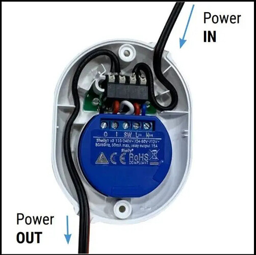

Sorry let me explain better. I’m looking for a solution to replace the switch of the lamp itself, not the switch in the wall. That’s why I was asking for an alternative of the shelly button.
Maybe a picture would help then.
ok.
This is the shelly button:
basically is an enclosure and a mini terminal board to be connected to a shelly 1.
I’m looking for an alternative to be used with a zigbee device (so I will expand my zigbee network )
How about a picture bigger than a postage stamp? Or a link to the product page. Your description is quite confusing.
Here it is. Thanks
That’s a switch. I’m looking for an enclosure.
For example sonoff have the ZBMINI-L2 (ZBMINI-L2 - SONOFF Official) thatt works without neutral and it would be perfect to replace the normal switch of table lamps:
I’m looking for a plastic box in which I can put this ZBMINI-L2.
The Sonoff Basic ZBR3 could work like that, but it seems to be unavailable everywhere and the alternatives are scarce.
I guess you best bet is to
get a fireproof plastic box
drill 2 holes for wires
put a wire through each hole and use a strip, like the ones below, to fixate them.
find a button in an electric store (a button goes back to the starting point after being released, where a switch stay in the end point position)
drill a hole for it and mount it
connect the parts to the ZBMini-L2.
