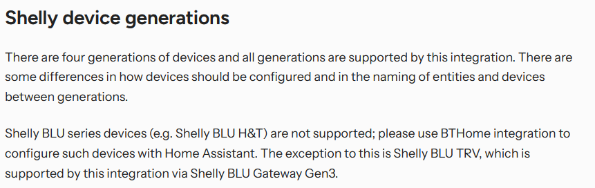

You need to configure your gen2+ devices as bluetooth proxy Shelly - Home Assistant
Shelly BLU series devices (e.g. Shelly BLU H&T) are not supported; please use BTHome integration to configure such devices with Home Assistant
I already tried adding BTHome to my HA setup but got the “No devices found on the network” error when adding the BTHome integration.
Edit: for my Shelly Plus 2PM I have Bluetooth + RPC enabled, is there another setting I’m missing in the Shelly software?
Have you read the Bluetooth support section in the documentation I linked to?
see Multiple Bluetooth proxies - #4 by jhol-byte as well
Somehow I overlooked the bluetooth setting in HA, the button shows up now, thank you!
