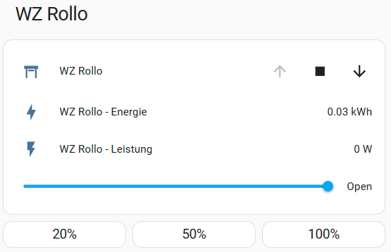

Hej,
you can do this using the api of the Shelly’s.
Defining actions in configuration.yaml
rest_command:
  rollo_wz_100:
    url: "http://192.168.33.1/rpc/Cover.GoToPosition?id=0&pos=100"
    method: get
  rollo_wz_50:
    url: "http://192.168.33.1/rpc/Cover.GoToPosition?id=0&pos=50"
    method: get
  rollo_wz_20:
    url: "http://192.168.33.1/rpc/Cover.GoToPosition?id=0&pos=20"
    method: get
Just a button (YAML Config)
type: button
tap_action:
  action: perform-action
  perform_action: rest_command.rollo_ku_50
  target: {}
show_icon: false
… all together (YAML Config)
type: vertical-stack
cards:
  - type: entities
    entities:
      - entity: cover.wz_rollo_shelly
      - type: custom:slider-entity-row
        icon: mdi:blinds
        full_row: true
  - type: horizontal-stack
    cards:
      - type: button
        tap_action:
          perform_action: rest_command.rollo_wz_20
          target: {}
        show_icon: false
      - type: button
        tap_action:
          perform_action: rest_command.rollo_wz_50
          target: {}
        show_icon: false
      - type: button
        tap_action:
          perform_action: rest_command.rollo_wz_100
          target: {}
        show_icon: false
title: WZ Rollo
Finally
Hope this helps …
Dirk
