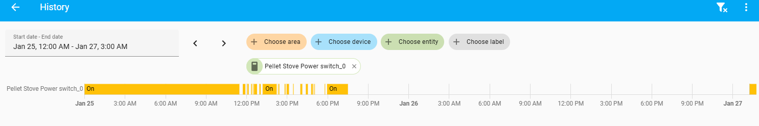

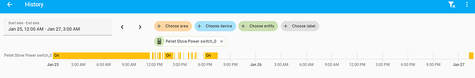

Has anyone found a solution for this? I have been using the Shelly Plus Plug US to monitor power usage on freezers, but recently found that they were dropping and becoming unavailable. After an undetermined amount of time, they would reboot completely, but would generally be in an off state for several minutes during this time. I had set a timer to auto on them, but that doesn’t seem to really help.
After my YoLink would report troubling temperatures in my freezers, I realized it was related to these devices. I contacted Shelly and was told that it was being reset on a timer, but my HA is not trying to set a timer on these devices that I could ever find. It’s currently 1:30am and another one of these turned off, but this time on my pellet stove and smoked up the entire house.
When I go to check the switch in HA, there is some troubling history that looks like this:

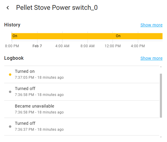

Unfortunately, adding the outbound websocket doesn’t completely eliminate the issue. The switch may still turn off, but it appears that it is only off for a few seconds (28 in this case).
