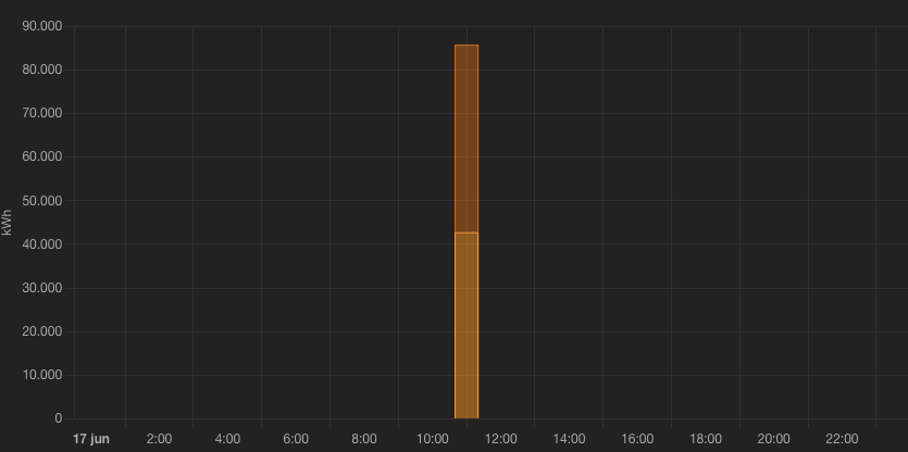

I am also having issues with Shelly EM kWh counter. From one day to the next, my two energy sensors jumped from 1.000 kWh to 40.000, which has corrupted my energy consumption statistics. What can I do to fix this?

      "total": 44024051.8,
      "total_returned": 0
      "power": 409.59,
      "reactive": 12.4,
      "pf": 1,
      "voltage": 231.96,
      "is_valid": true,
      "total": 44049899,
      "total_returned": 0
