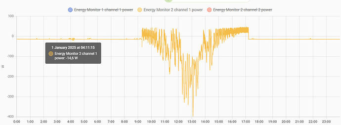

The new solar installation is showing a nightly returned energy of about 14,5 W, which I find rather high. The old installation also shows a nightly returned energy, but limited to 3,5W. As a result, the energy dashboard in HA, is showing a constant return value each night.
PS: when the night is over, I see limited positive peak where the inverter is activating, showing it is (for a short moment) consuming power, which also suggests me that the inverter (Solis) is turned off at night. The old inverter (+15 year old, no datalogger) doesn’t have this behaviour.

Measurements of this morning, including 15/20 min of positive power usage by the new inverter (yellow/red). The old one doesn’t have this. I do find this a bit weird, the solis manual doesn’t really specify this behaviour.
Confirmed, when the inverter is shutdown (via his own breaker), the power becomes 0. So it seems the inverter is passing down an constant return of 15W for no apparent reason (during the night).
