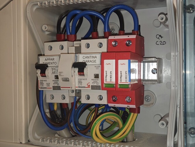

In my basement, immediately after the utility meter, there’s a junction box where the line splits into two branches one feeding the apartment and one feeding the garage.

For anyone reading this later I opted for the second configuration due to space constraints in the junction box. Clamping the apartment line directly was impractical and prevented the cover from closing properly.

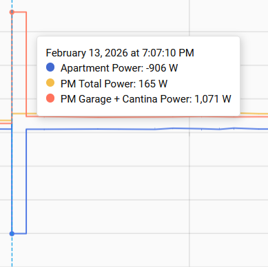

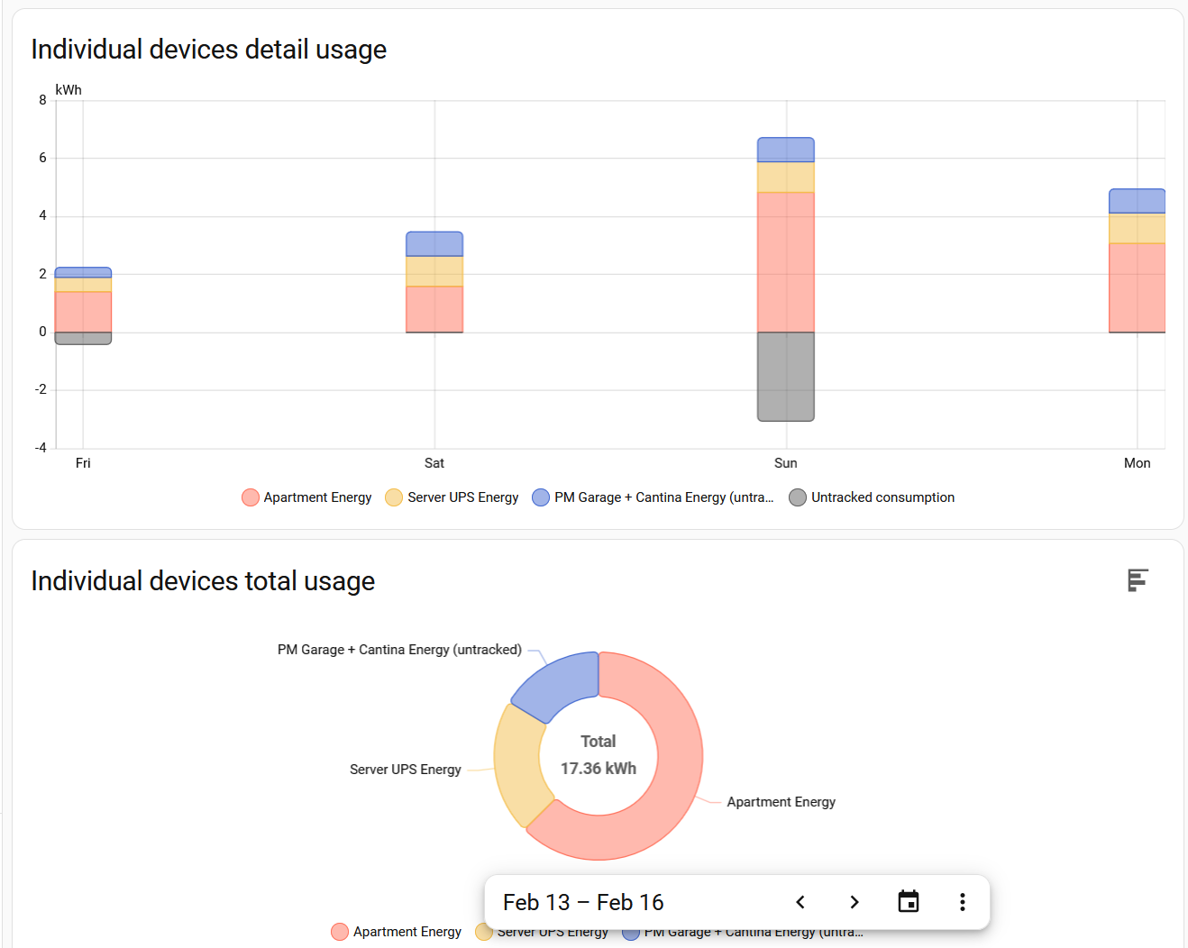

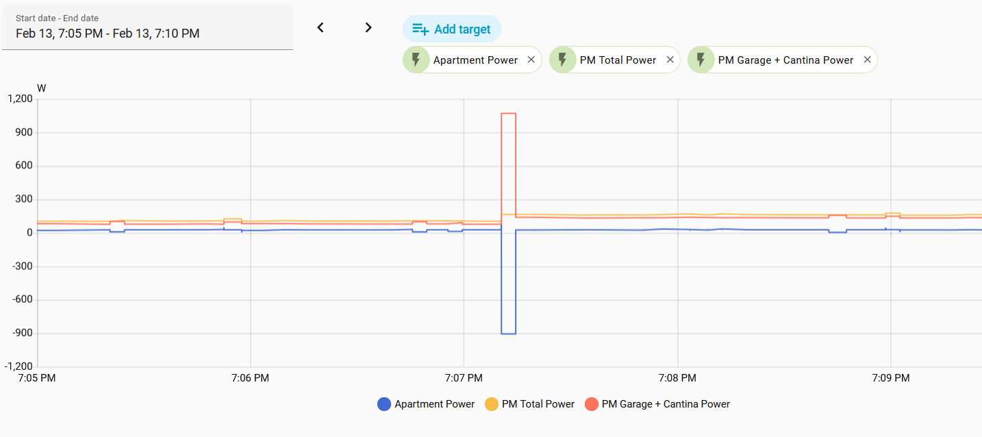

After some days of data collection I am noticing a deviation in the measurements collected resulting in negative (exported) untracked energy in the Energy Dashboard. The amount is significative.
While looking at the individual sensor values I noticed that the Apartment Energy/Power goes into the negative sometimes. (Blue line in the graph)
When zooming in the apartment negative values I can see that the Shelly, somehow measures a Total Power which is less than the Garage Power, which is impossible from an electric point of view given that CT0 measures from the utility meter and CT1 measures a sub-branch.
From my understanding of the situation when a power increase happens in the garage (red line) it is measured correctly by CT1 (the second clamp), while the Total Power CT0 doesn’t reflect the consumption increase, thus resulting in Total Power < Garage Power
It’s like CT0 is slower to react to the power change or it is out of calibration or something else?
