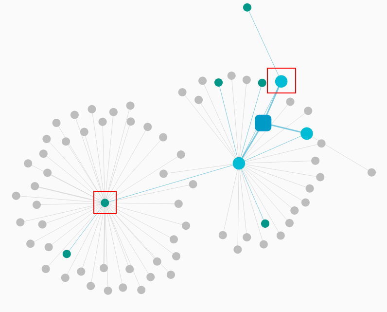

I have a couple of Shelly PlugS Gen3. I expect both to act as proxies as they are, as far as I know, configured identically. I see however, thanks to new visualisation tool (/config/bluetooth/visualization) that one plug is picking all the connections and the other one is not, even when closer to the potential client.
Did anyone figure out a possible reason?
Luck of draw I guess. Physical closeness and best signal can be two different things.
I am not sure how devices choose where to connect. Only the writer of the firmware may know
Putting the plugs side by side still produces the same result. Even when inverting them.
