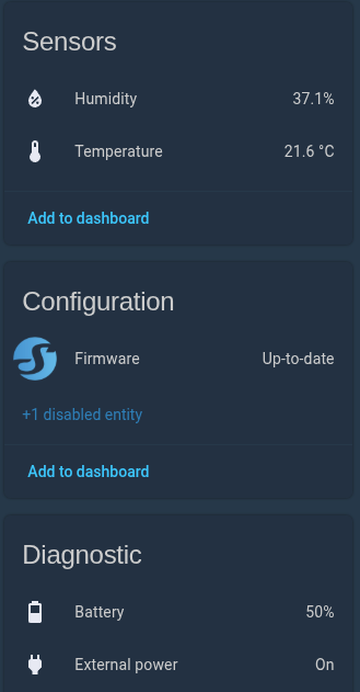

Hi guys,
I just figured out how to bypass the issue with the update interval running on battery.
I simply measured the voltage when on battery and on USB and just gave it a try to solder a bit.
So far the Shelly reports that it’s powered via USB. Fortunately it still reports battery percentage to Home Assistant :slight_smile:
Let’s see how long the battery will stay alive. I personally don’t care about changing it every two months.
IMPORTANT: Once you soldered this connection you must not connect it to USB power supply as long as batteries are plugged in! So either batteries OR USB.
Happy soldering… and it comes with absolutely no support and no warranty.
Greetings
Chris

I tried the method suggested by chriz239, and before the modification the battery reported by Shelly H&T Gen3 was 70%. After about a week, it now reports 51%. At the moment, the temperature updates approximately every 10 minutes.
I also did the chriz239 mod. Good quality batteries last about a month.
