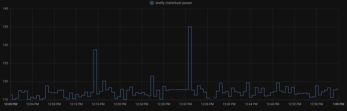

Below you can see a higher frequency on update via MQTT
this is based on shelly integration:
this is based on shelly mqtt:
