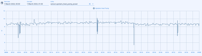

I tried port 5683 and that works for me (updates in intervals between 1 and 15 seconds)! Thank you very much @tonicb !
grafik
