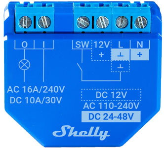

Shelly Plus 1 Button Action Blueprint
I created a blueprint for easily creating an automation from the various button presses on a Shelly Plus 1. It can probably be used for other single-button Shelly devices as well, but it’s not tested. If you successfully used it on other Shellys, please let me know below and I’ll update the description.
