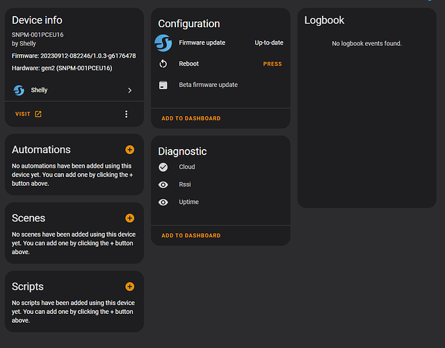

I have recently started using Shelly gear and everything has been working fine with gen 1 devices like plugs and relays. But when trying the Shelly Plus PM Mini (gen 2) to just measure consumption, I´m having problems with the relevant entities not showing up in Home Assistant. (I only get the reboot and firmware upgrade etc).
I run the devices on a separate VLAN from Hass and multicast is not an option which means that I have to add the devices per IP and set the ColoT for gen1. For gen 2 I am using the outbound websocket which seems to be working fine.
Looking at the logs, the values are reported in from the PM so what do I need to do to get it all the way with the Shelly integration?

Did some surface investigations and only see responses from the PM which carries pm1:0 aenergy but not the voltage and power information.
Everything is fine in the webserver of the shelly and I nearly changed every setting, like indicated by @blaine but without success. Difference is, I have not used the app, but I would really be surprise, if this causes the difference.

I still see the difference, that you are using the mini1pm which comes along with the switch AND the measuring function. Whereas my and the thread initiators device is a PM only.

and the device is just giving me 6 entities, among which some are coming from the fritzbox integration and others are trivial (reboot, uptime, fw-update, …)
In the meantime I noticed that the aioshelly component used in the installation of my HA instances is kind of outdated. It doesn’t list the device I am using in the list of shellys in const.py.
Quick trial of adding it simply to the list, didn’t brought any improvement - what a surprise.
