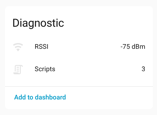

:bar_chart: MQTT Discovery: Scripts Monitor
This is a script designed to run directly on your Shelly Gen2+ device.
It monitors the state of all installed scripts and pushes that data to Home Assistant. The state of all installed scripts is collected and reported to sensor entity, which is registered in HA using MQTT discovery.
The entity tracks the total number of running scripts and provides deep-dive attributes for each one:
Example of sensor attributes available:
  "scripts": [
      "enable": true,
      "id": 1,
      "mem_peak": 14294,
      "mem_used": 9282,
      "name": "ble-pasv-mqtt-gw",
      "running": true
      "enable": false,
      "id": 2,
      "name": "mqtt-discovery-self",
      "running": false
      "enable": true,
      "id": 3,
      "mem_peak": 4270,
      "mem_used": 2982,
      "name": "scripts/mqtt-discovery-scr-mon.shelly.js",
      "running": true
      "enable": false,
      "id": 4,
      "mem_peak": 12852,
      "mem_used": 9268,
      "name": "mqtt-discovery-self.shelly.js",
      "running": true
      "enable": false,
      "id": 5,
      "name": "test",
      "running": false
      "enable": false,
      "id": 6,
      "name": "test.shelly.js",
      "running": false
  "scripts_mem_free": 3178,
