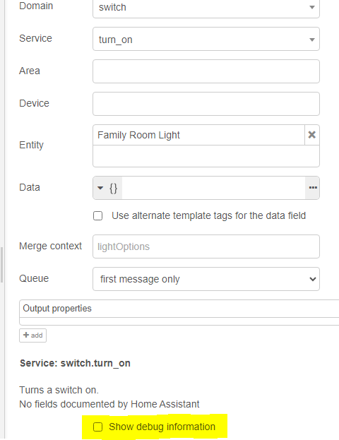

Please post your call service code.
Change Domain from light to switch.
same problem, the node say switch turn off, but nothing happend
Where can I see this debug information?
In the right side panel.
There is all empty
After you check the box, deploy. Trigger the flow and you should gt a message in the debug panel.
Now I have a answer
domain: “switch”
service: “turn_off”
target: object
