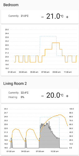

I miss this feature quite a bit, as other TRVs that using Zigbee protocol usually report it. Here you can see a graph from the Shelly TRV on the top, and Zigbee TRV on the bottom:

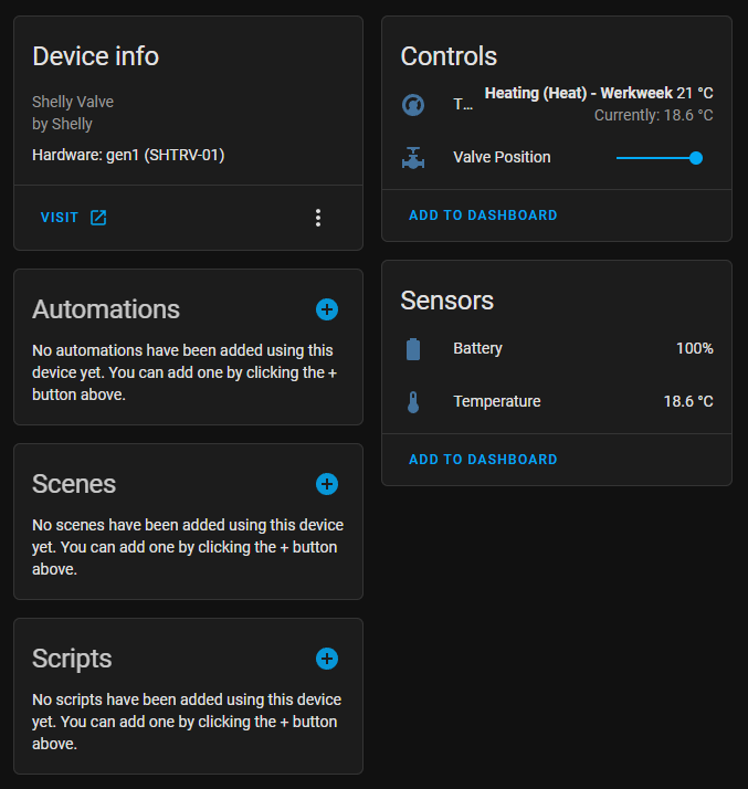

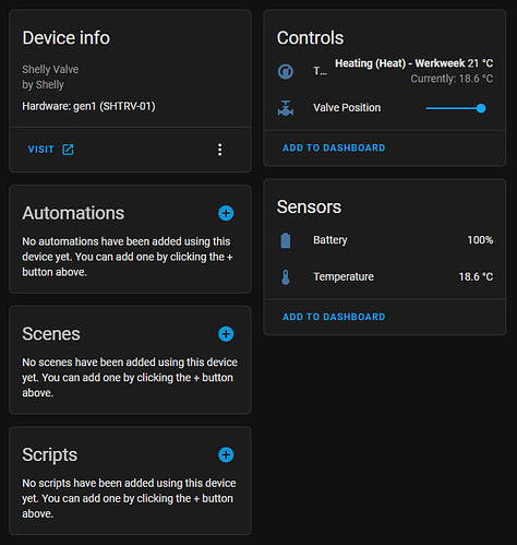

This is weird, I installed 5 Shelly TRV, same firmware, same settings (besides the name) and in the bathroom TRV the “Valve Position” is shown in the integration, the other 4 not. I double-checked the settings but can’t find anything diffferent in the bathroom TRV. Why does it show the valve position there (it’s even adjustable and the valva actually responds) but not the others? Weird …
I found a workaround:
  • remove the device from the integrations
  • in the Shelly TRV website deactivate Settings → AUTO TEMPERATURE CONTROL → “Enable automatic temperature control”
  • add the TRVs again in the settings
  • the valve position is available as a entity
That worked !
Thank you for the tip.
