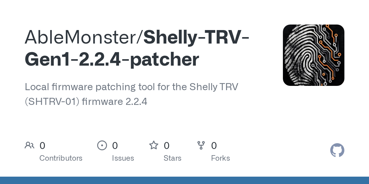

Open-source patcher
To avoid distributing modified Shelly firmware, I have published a small open-source patcher.
It creates the patched firmware locally from the user’s original Shelly 2.2.4 GBL file.
No Shelly firmware is distributed by the project.
The patcher is intentionally strict. Before modifying anything, it validates, among other things:
  • firmware size
  • SHA-256
  • GBL structure
  • CRC
  • expected ARM/Thumb instruction
After patching, the resulting firmware, CRC, and expected byte differences are verified again.
The project also includes a small local HTTP/1.1 OTA server with Range support for transferring the resulting firmware to the TRV.

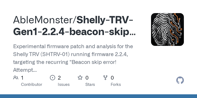

Patcher:
Full reverse-engineering research and technical details:
Current patcher release:
