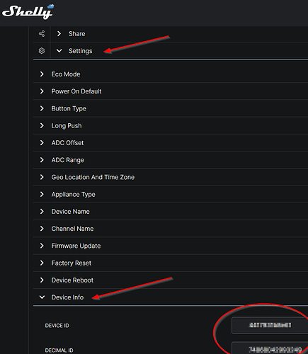

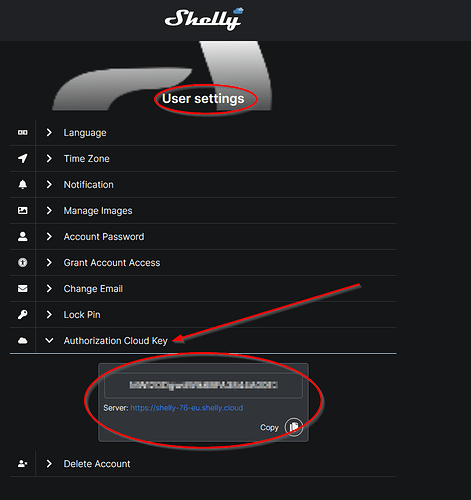

Then you need to obtain the API (AUTH) key and device ID and server URL, which are also obtainable within the account / app (or directly on the device via the IP address or Shelly App. The device ID is available on the device info page on each device, and the other 2 items are available on the settings page under ‘User Settings’.
