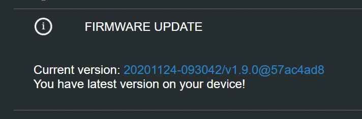

Also a comparison of firmware versions between you two may be revealing.
I’ve checked with 2 meters and on the latest firmware.
