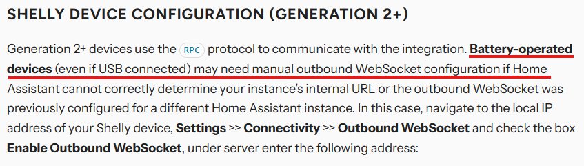

Gen3 devices have BLE, RPC and outbound WebSocket enabled, and appear fine in HA otherwise.

You should not enable WebSocket outbound for mains-powered Shelly devices.
