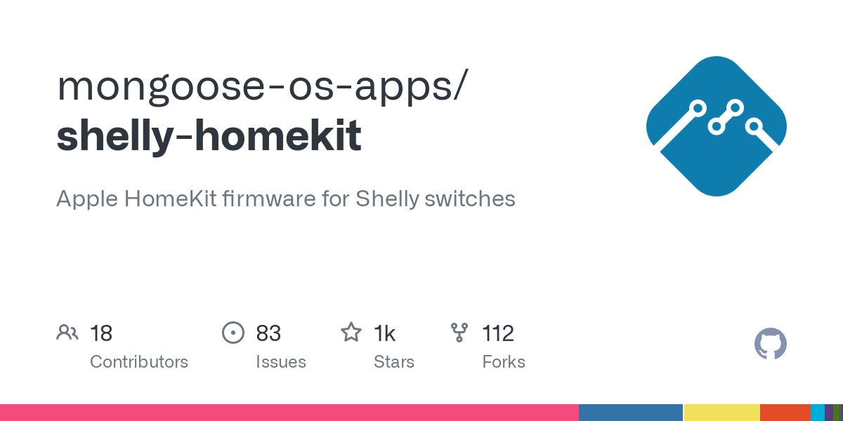

Just in case anyone stumbled here intending to rollback a Shelly Gen2 (Esp32 based - plus series) device. The above logic might not work as it seems to be for ESP8266. Further Shelly does not seem to be providing Gen 2 devices firmware on their website yet.
So firstly, you need to get the firmware. For this I used the below project which provides links to latest firmware:
Afterwards, I downloaded mos tool (which is from mongoose os used by Shelly Gen2 for OTA, etc):
https://mongoose-os.com/docs/mongoose-os/quickstart/setup.md
And lastly, after attaching the USB serial adapter to Shelly hardware with GPIO0 set to Ground (ready for flashing) executed below command:
mos flash --esp-baud-rate 921600 Plus1PM.zip
That’s it the device booted with shelly firmware restored. I doubt that my power meter calibration, etc was restored. So in case you have not yet flashed original firmware, it would be best to take backup of the original firmware with all calibration files using the same mos tool before you venture into updating original Shelly firmware to tasmota or esphome.
Note: Change the filename to whats suitable for your device.

Hey, is the firmware you linked original shelly? Seems to be Apple HomeKit
I think I looked into the source code of python file mentioned in " Reverting to stock firmware" section to get the firmware file url.
I ended up flashing shelly homekit and then used the revert function.
