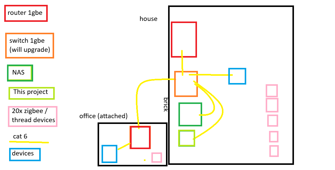

  • Behold my exceptionally technical drawing:
  • I can’t see a reason I couldn’t put the NAS and this project in the office and upgrade the switches, but Dunning-Kruger makes me cautious.
  • I have more space in the office and space where the ethernet terminates is very limited.
  • House is small 160m2 lot, two storey, HA devices on both floors.
  • Routers (current switch) have 1gbe ports. Will upgrade switches.
