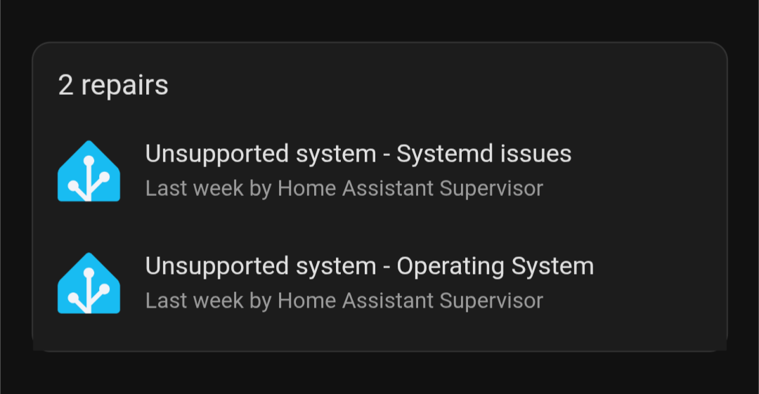

I looked at home assistant today, it’s telling me there’s problems (see images)
Systemd is missing
Unsupported os
And I need to switch installation modes
This is on the ha green appliance

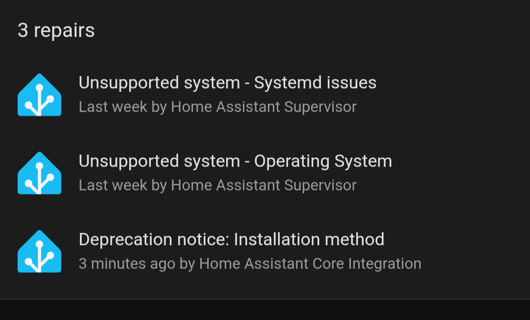

OK…
I rebooted the box, and…
Down to two errors

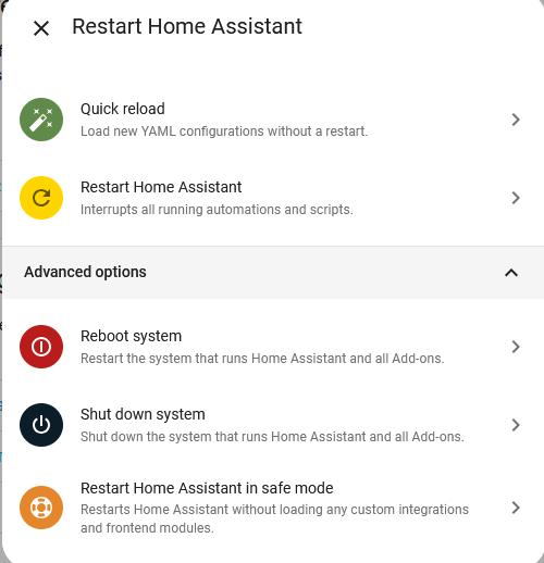

I tried safe mode, that didn’t help.

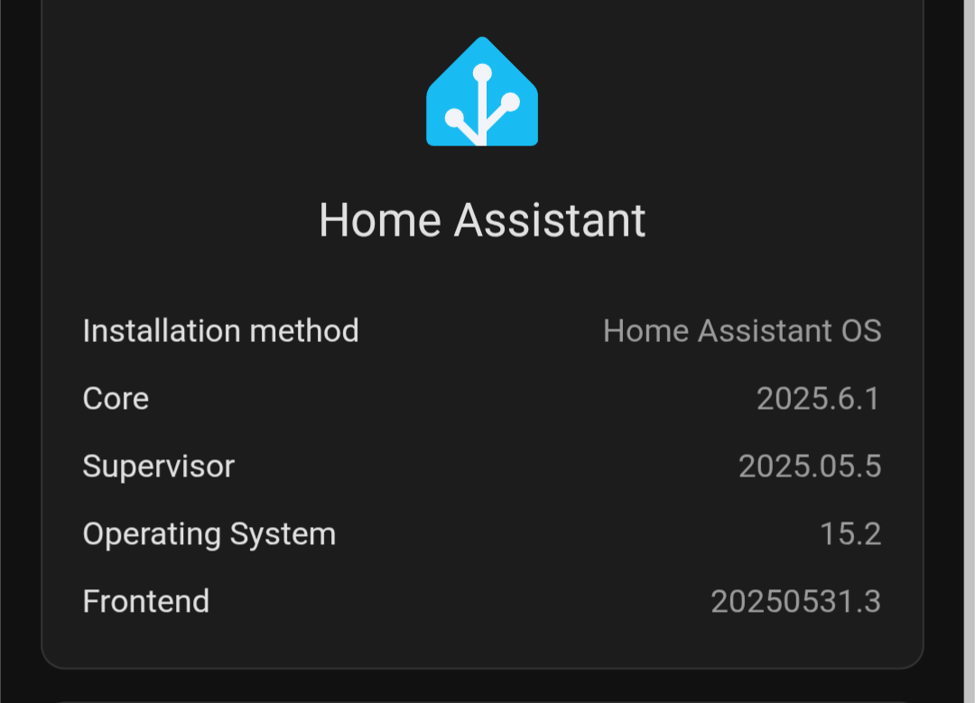

What OS are you running now ? Settings → about
if your OS is 15.2 you can try
ha os update --version 15.1
if it is not 15.2, try
ha os update --version 15.2
