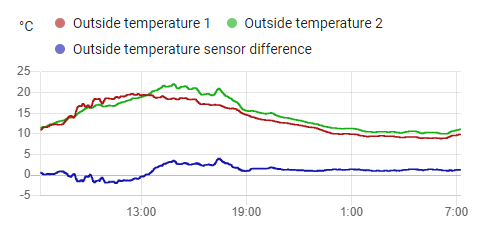

Yesterday’s plot of the two sensors (red and green), and the difference (blue):
The “actual” temperature sensor isn’t shown but is the minimum of the red and green at any point.

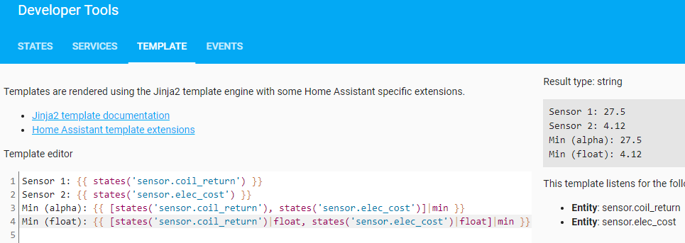

Note that @Hellis81’s example doesn’t include the float conversion, so whilst it will appear to work when the two sensors have the same magnitude, note that "9" is bigger than "10" in the same way that "z" is alphanumerically “greater” than "apple".
Here are two of my sensors to show the problem — "27.5" is alphanumerically smaller than "4.12", but 4.12 is numerically smaller than 27.5:

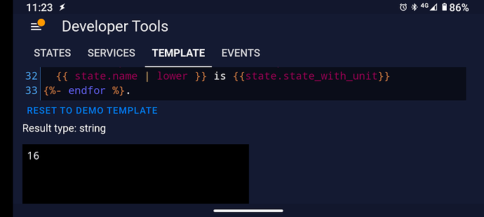

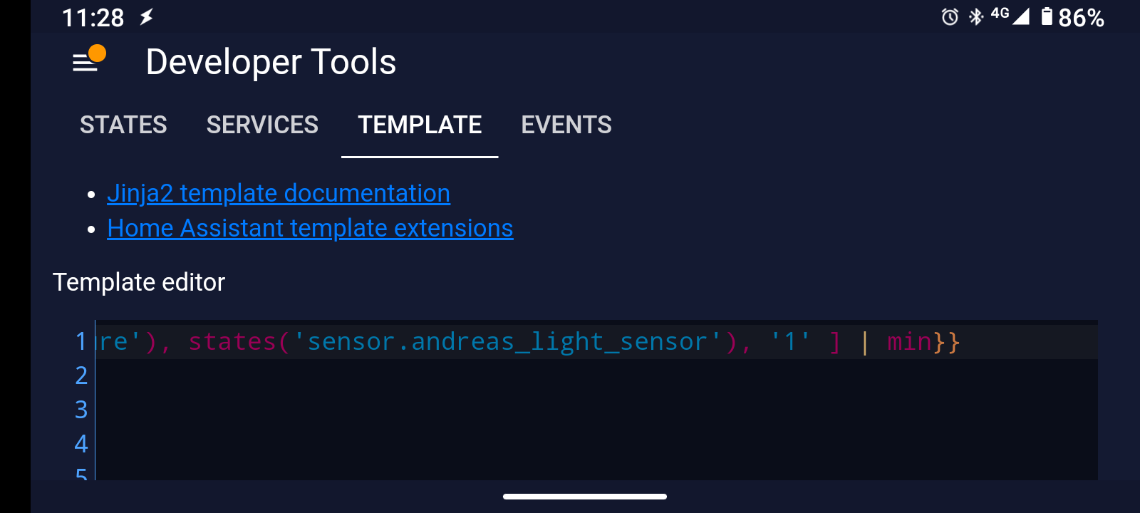

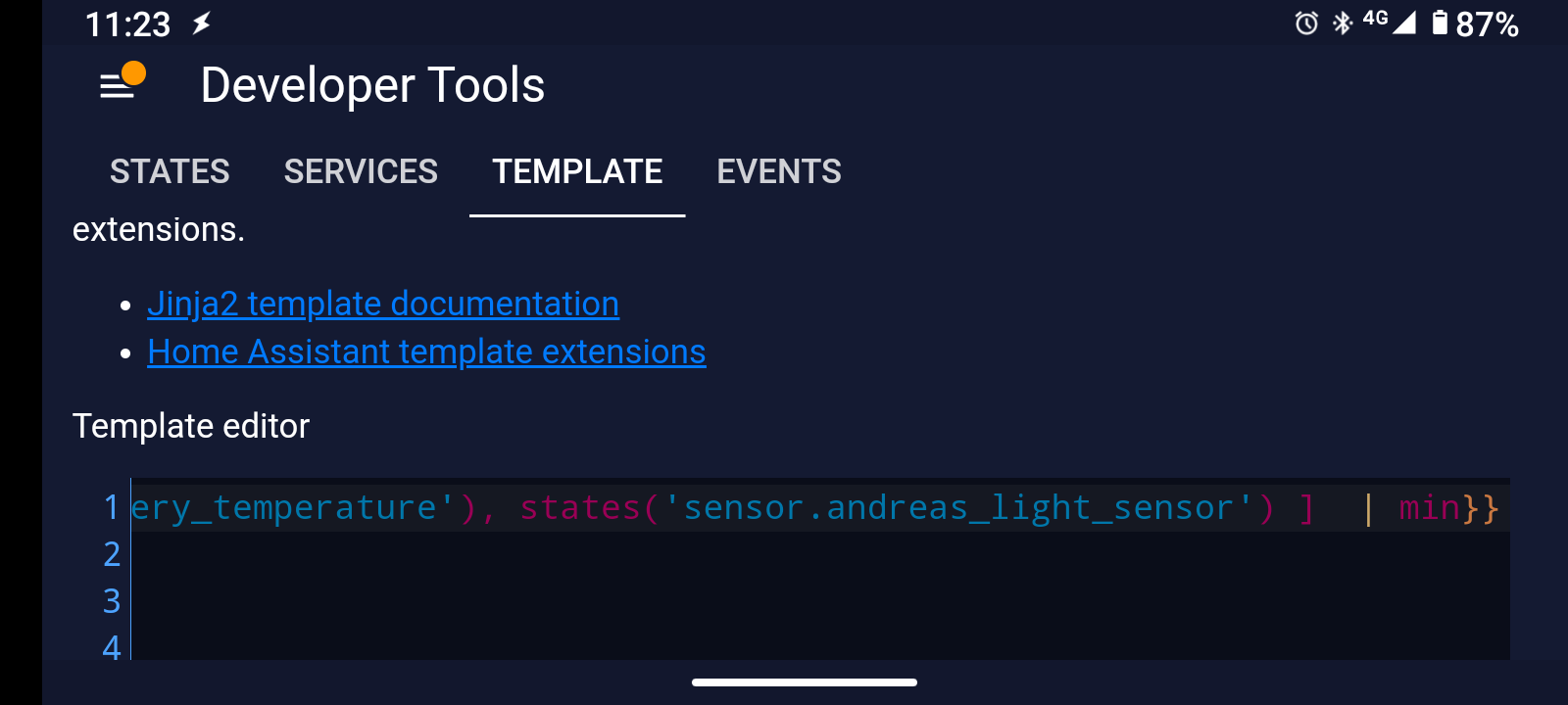

And here is the list:
Naturally the light sensor changes, but it’s still less than the battery temperature. And it doesn’t matter if I switch them around

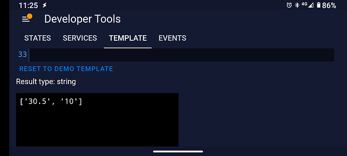

You really do. Try it with "3.5" and "10".

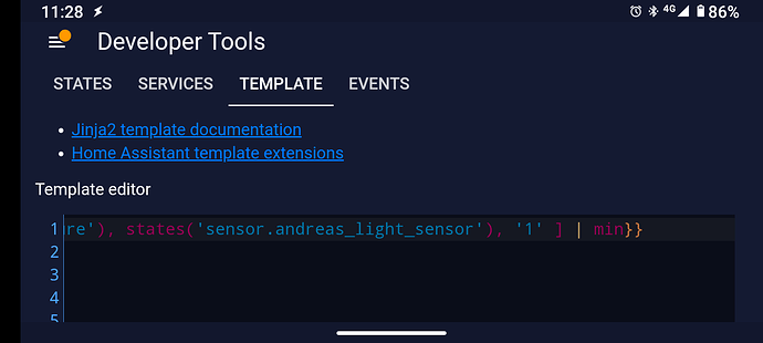

Why don’t you try something yourself?!

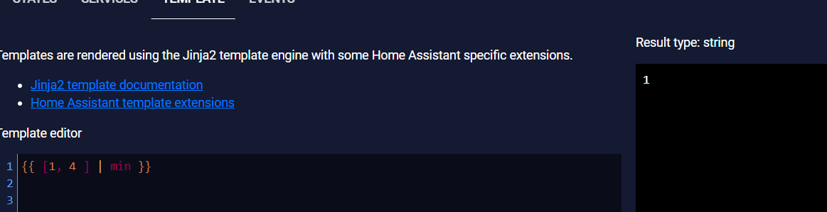

Can you guess what this gives me?
That’s right 1

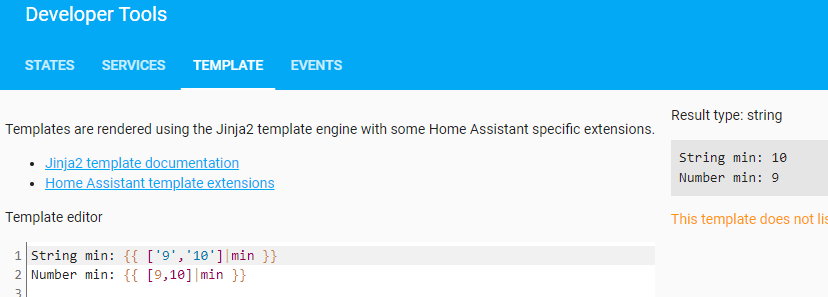

I have tried: see my screenshot from my big post above. What does {{ ['9','10']|min }} give you?
Like I say, the min of two strings will appear to work when the values are of the same order of magnitude or happen to be correctly sorted, so 27 and 31 will work, as will 2.7 and 31 — but 270 and 31 won’t give the right answer if you min the string values.
