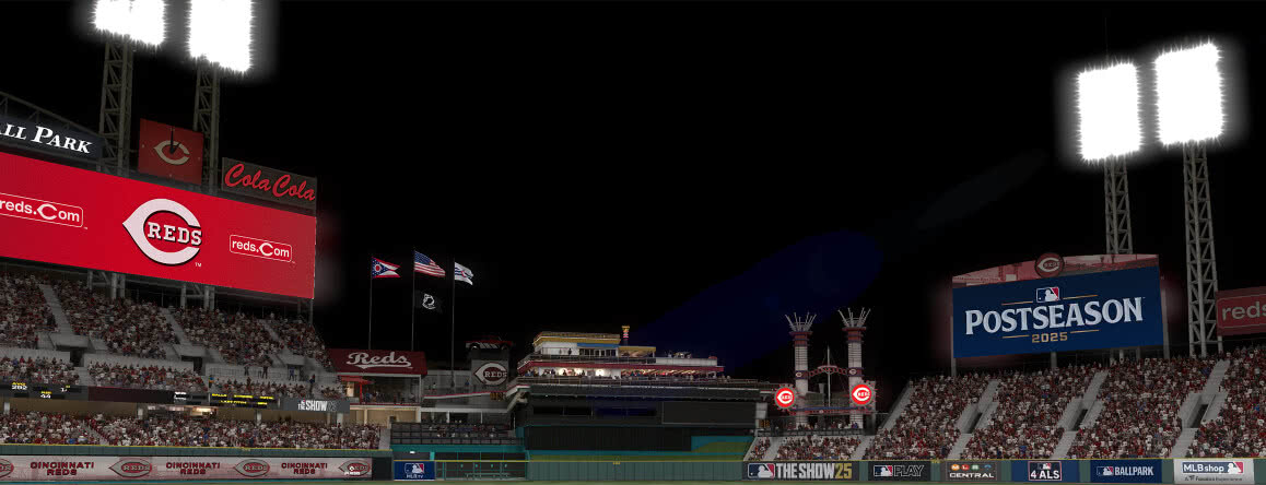

Show your MLB game info
The current project is a card that will stay updated with my Braves. The background image will actually change based on the venue. I have been working on the code for the background image and now I just need to fill in with scores and other info I decide on.
I’m sure the code can be cleaned up, I pulled the code from HERE and just added it to what I was looking for. Having trouble coming up with a design for the Lovelace card.
