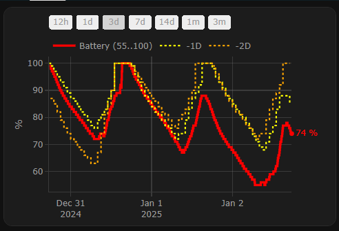

I know the thread talks to AVERAGE, but I find it usefull to compare to the previous 2 days, using plotly graph. So the yellow line is representing the value 24H before the red line, and the orange line is -48H.
